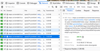

I would suggest having one of the team members open their browser's developer tools when they open the map and watch the network traffic. If one of the requests is failing, you may see it there, which could help you identify which layer(s) are causing the issue.
