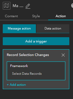

On the corresponding Map widget, add a trigger to Select Data Records when a feature is selected in the map.
The embed widget should reload when features are selected.
