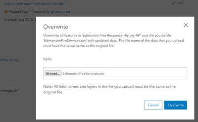

AndréPiasta
@Anonymous User , I can verify that this is occurring.
I tried this very thing last evening for a course we have here in Canada, and a simple hosted feature layer (<17AGOL_FL_OverwriteERROR_1.PNGAGOL_FL_OverwriteERROR_2.PNGAGOL_FL_OverwriteERROR_3.PNGk rows) that was created from a CSV file, could not be updated/overwritten with a second CSV file (same name, just about 50 added rows) and the above-noted error was the result.
The *very* weird part is that this worked, approximately a month (or so) back, without issue.

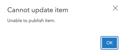

EmmaHines
Hi folks - I'm similarly getting an error message, although it's a bit different of a message. It reads "Cannot Update Item, Unable to Publish Item." The CSV I'm uploading to overwrite with has the same title and field names as the original, and I doubled checked the special characters that you all discussed here before. Any ideas?
