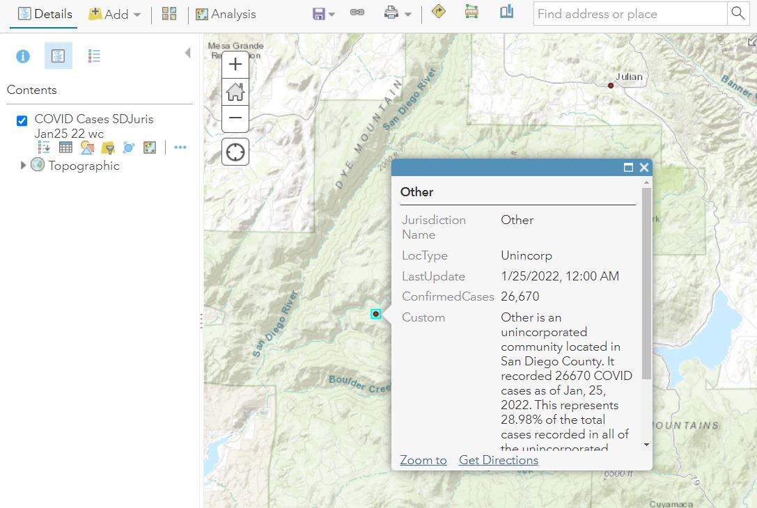

Expression tested fine in the new and classic viewer
Arcade expression doesn't show in new viewer's pop-upArcade expression doesn't show in new viewer's pop-up
New viewer pop-up fails to update with the message from the expression
 Classic viewer pop-up updates with the message from the expression
