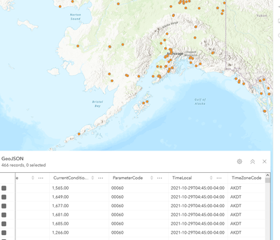

I have a static geojson file that I add to my map in ArcGIS Online. Everything displays fine. The issue is:  AGOL is not honoring the type of attributes specified in the geojson file. I'm attaching what the data looks like in the geojson file and what it looks like in the the table or 'identify' in AGOL. Take a look at the 'SiteNumber' or 'ParameterCode' attributes. AGOL is treating them like numbers instead of strings. Cutting off the leading zeros in the 'ParameterCode' is not good :(. The data type in the geojson file are honored when I add the same dataset to a QGIS session or consume it with other apps.

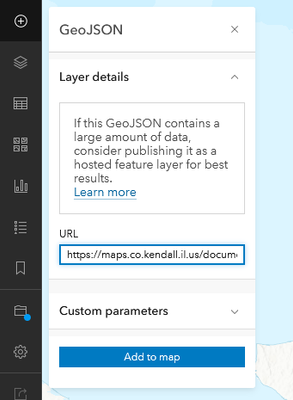

If you host the file at a URL and add it to the new map viewer, it respects your data types!
Why the difference? Who knows!

DonaldBrown
Ooooh, that is good news! Thanks for taking the time to create the geojson service and testing it. My goal is to create a geojson service (and NOT use a static geojson file) anyway, so I'm less concerned now. Anyway. it would be nice if ESRI could fix the static geojson upload issue.
