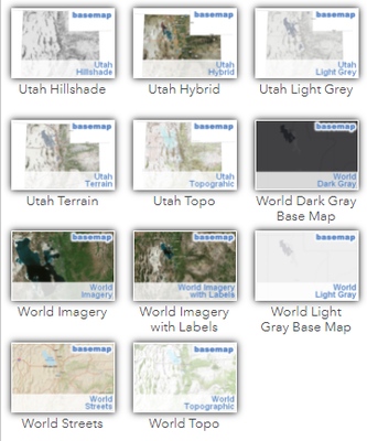

Here is me setting up the basemap that is in the gallery.  The other picture is me setting the basemap gallery in my app. It should be the land ownership basemap but it doesn't draw the SITLA layer in the basemap.

Ken, what app are you trying to use to see this grouping of basemaps? And can you view non-grouped basemaps? I have seen similar behavior from similar data sources. I was making a story map and my embedded web map would not show the basemap if it was a wmts from the UGRC or so, like any of these:
So I had to stick with default Esri basemaps.

I am using the web app builder and the crowd source apps. I can get our standard org base map gallery, which uses the UGRC maps and the standard ESRI basemaps to work. All their data works fine. Its just when I try to use my own custom gallery that data in the basemaps stops drawing. I would see about adding a map to the org gallery but the admins don't want to clutter our gallery with basemaps that are only used in one or two apps. I did try individual maps as basemaps today and it still didn't like the data. I will look and see if my data is being pulled in as wmts.
