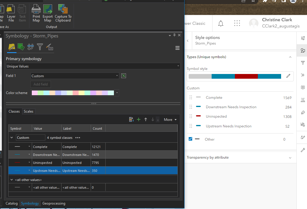

Our most telling test targeted a single field: "EndsInspected", which contains the values 0, 1, and 2.
If we select that field from the field list in AGOL and symbolize, we get the correct feature counts, regardless of upload method.  If we instead symbolize on the Arcade expression
return $feature.EndsInspected
 we get incorrect feature counts on any map that was published from within Pro.  If the map was produced according to Case 3 above, the feature counts are correct.
Below is an image showing the feature counts for our intended two-field expression.  It's checking for non-null values in two different inspector fields.  This is from our Case 1 attempt above.
I'm still not sure if the error is just in displayed counts in AGOL for the broken cases or if the error is in the underlying data.  I'm also not sure yet if the problem's happening on the Pro side (a "pitching" error) or the AGOL side (a "catching" error).
