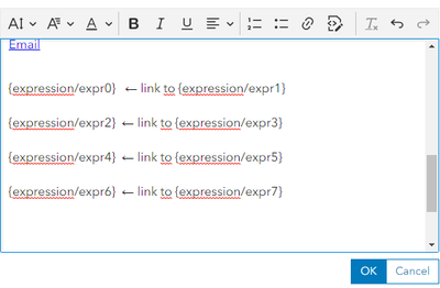

Your popup would look like this:

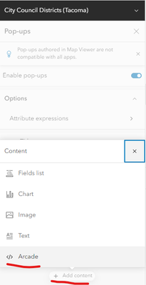

The new and far better way: Just use an Arcade element! With this element, you can return HTML code which will be interpreted by the popup.
var areas =FeatureSetByName($map,"Neighborhood Council Districts (Tacoma)");
var Onefifty = Buffer($Feature, -150, 'feet')
var countp = Intersects(areas,Onefifty);
var result = "";
for (var item in countp){
    var name = item["Neighborhood"];
    var url = item["URL"]
    result += `<a href="${url}" target="_blank">${name}</a><br/>`
return {
	type : 'text',
	text : result
var result = "";
return {
	type : 'text',
	text : result
