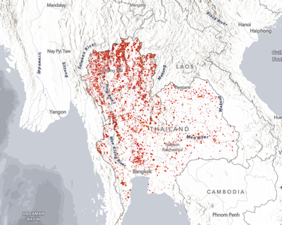

You can use a combination of group layers plus blending effects to visually filter the VIIRS hotspots for a country.
Below I've applied a filter for Thailand on the Living Atlas World Countries layer and placed it in a group layer above the VIIRS hotspots. Using Destination In blending, the hotspots are visually filtered in the map.

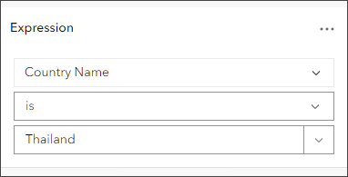

Step 2 - Filter for the desired country in the countries layer:

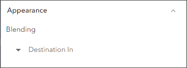

Step 3 - Then use  Destination In blending on the countries layer in Properties:

Thanks, that's awesome.
AndrewCastilloTBSL
Thank you, I performed your instructions, and I was able to visually focus it on my specific country.
