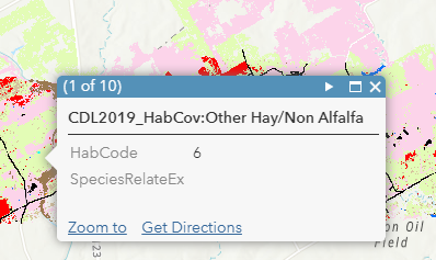

Popup only shows the expression label and then no value even though the arcade expression works in the test expression window.  I followed the blog about using featuresets to create a relate and add it to a popup - https://community.esri.com/community/gis/web-gis/arcgisonline/blog/2020/06/09/show-related-data-or-t... - Gee Fernando's Blog

How are you linking the script to the popup? Do you have it checked in the Configure Attributes dialog?
ShawnLanning
Yes - I believe I have the pop-up configured correctly and even created a very simple arcade expression that does work, though I could be missing something?  See below:
