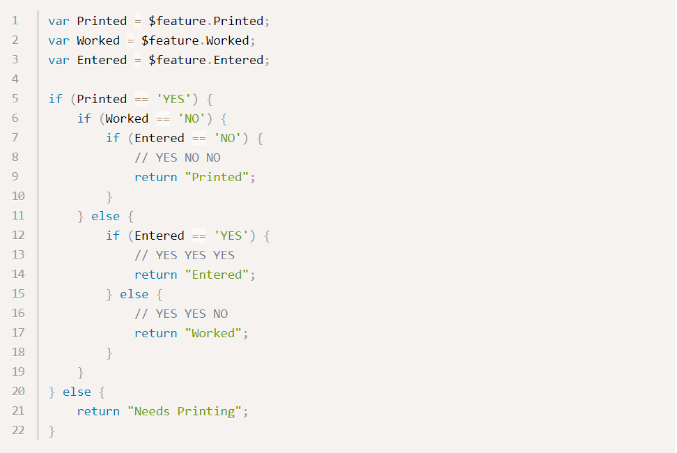

I am trying to write an Arcade expression for symbology I need in a web map in Portal. The problem I can't overcome at the moment is that the symbology needs to be based on 3 different fields. I've attached two text documents in vb script format that detail what exactly needs to fall under which category. There are 'Homes' and there are 'Passings'. For Homes, we need active accounts, certain service ID's, and certain rate schedules. For Passings, we need inactive accounts, certain service ID's, and certain rate schedules. So far, I haven't been able to figure out how to write the expression for these scenarios. I can use the concatenate function and that works, but that leaves me with dozens of combinations, so I'd rather not have to manually go into the symbology editor and adjust them one by one. I'd like to be able to group the combinations into Homes and Passings.
I've seen the below solution in another article, but that would take a while to write out every possible scenario
Is there an easier way to write out this scenario?
Thank you!

Hey Adam Bakiera‌,
You could use an AND statement in your if statement to drill down to the level you are after. You will still end up with quite a few different if statements. I would do something like
if(Printed == "Yes" && Worked == "No" && Entered =="No"){
return "Printed"
That might make it a bit easier to write.
Happy to discuss further.
Thanks,
Ben

Hi Adam Bakiera ,
You can also consider doing something like this:
var case = $feature.Printed + $feature.Worked + $feature.Entered;
var dct = {"NONONO": "Needs printing", "YESNONO":"Printed",
           "YESYESNO": "Worked", "YESYESYES": "Entered"};
if (HasKey(dct, case)) {
    return dct[case];
} else {
    return "Invalid combination";
What I did is create a dictionary that contains the valid keys (valid combinations of printer, worked and entered) and if the combination "case" is inside that dictionary, you return the text you want. Probably the additional validation of checking if it is inside the dictionary might be redundant, if your data is consistent. In that case you can simplify it to:
return dct[$feature.Printed + $feature.Worked + $feature.Entered];
Or even a single line (although it is not very good for readability):
return {"NONONO": "Needs printing", "YESNONO":"Printed", "YESYESNO": "Worked", "YESYESYES": "Entered"}[$feature.Printed + $feature.Worked + $feature.Entered];
