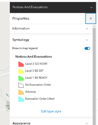

I am trying to figure out why my layer is not changing its symbology when I am trying to edit in AGOL map viewer. This is a layer created by the Emergency Management Operations Solution . I needed to customize the Notices and Evacuations layer for my organization. I need the Symbology to match and show my customized choices.Here is the Symbology for the layer

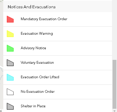

Here is the symbology when editing.
Hi @RickeyFight,
To update the choices in the Editor, you'll need to manage the feature templates. Support for managing feature templates within Map Viewer is on our future road map.In the mean time, you can use either Map Viewer Classic or the Field Maps Designer app.
To manage feature templates in the Field Maps Designer app, follow these steps:
Hope that helps!
@EmilyGeo Thank you for the help! I have not used Field Maps Designer.I am running into an issue on step 4. I do not see an 'Add Template' button.
I was able to change the template by using map viewer classic.
@EmilyGeo I their a webpage where we can track the current status of this new feature? Like Rickey, I have no option in Field Maps Designer to edit the existing template, or to create a new one.
Hi @BRENNEJM,
You should be able to manage templates for all layers that you own or administer. At this time, Templates can be managed in either Field maps or Map Viewer Classic.
To create a new template in Field Maps Designer, select an existing template and click the 'Duplicate' button, then update the attributes accordingly.
