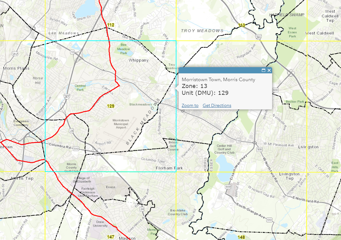

Hello!
I'm using the Arcade Intersects function to pull intersecting layer information and place it within a popup. I've come across a situation where multiple polygons (red border) from one layer intersect my main layer (yellow squares) and the popup only returns a single feature. Is it possible to pull the intersecting feature information where clicked on the map?
Example: The eastern side of the red line is zone 13 and the western side is zone 36. When clicked only the zone 13 information is populated within the popup. Is it possible to pull the information from the intersecting layer where clicked on the map?

When you configure an Arcade expression for a pop-up that should appear when clicking on a feature, you do not have access the actual location where the user clicked. You will only have the clicked feature geometry and not the exact location. (I hope this will be provided at some point in the future).
In your case the expression contains a loop and you use the return inside the loop. When the sequence hits the return, it will exit the arcade expression. So, you will only have the first feature (attribute) it found in the process.  To return multiple features, you will need to use a variable that you populate with the results and return that variable after the loop.
