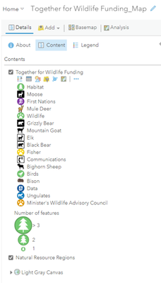

I've run into this multiple times and had multiple AGO users ask how to do this. Here is a guide I made using the AGO Assistant. Always make a backup before changing your JSON file. For your query, please refer to step 12 first - custom symbology using GitHub. Alternatively you can use another image hosting service.
  1. In the GUI of a Classic Map Viewer-saved map, identify and save the symbology of the feature layer you’d like to use:

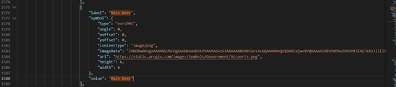

  1. In the new map viewer GUI, load in the feature layer of interest and use some random symbol from the new map viewer “Government” symbol selection folder on the symbology class of interest, save the map file.
  2. Open both the new map and the classic map JSON files.

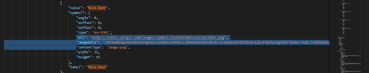

  3. CTRL+F the symbology class for the value in question in the classic map JSON file, e.g., “Mule Deer”.
  4. Continue to search until you see some associated URL and ImageData tag for the value:
  1. Copy only the “URL” and “ImageData” tags.
  2. Search for the same symbology class, e.g., e.g., “Mule Deer”, in the new map viewer file and skip to the result which has classes for the symbol:
  1. Replace the identical tags in the new map viewer file with the URL and imageData tags and save the JSON file.

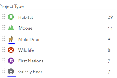

  2. Refresh the new map viewer GUI. Your symbol should be updated:
Figure 2 Mule Deer has been updated with the Classic Map Viewer symbology  class. Grizzly Bear still has a generic template symbol and will be updated next.
