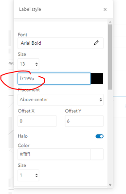

We've noticed some inconsistencies across the Map Viewer UI for the color
In the Symbology Styles settings, map authors are given the option to pick from the color gradient and the hex value's # is supplied.
In the Label setting, there is no color gradient option, and the hex value's # is not supplied.
This inconsistency in the UI leads to a confusing user experience and somewhat cumbersome experience when trying to choose consistent colors.
Symbology Styles settingsLabel setting
Color gradient picker availableColor gradient picker not available
hex value's # symbol providedhex value's # symbol not provided
Please update these UIs to be consistent.

Amanda__Huber
Hi @MarianneFarretta
Thanks for the quick response, I appreciate the update!
As for the hex value I was referring to the actual "#" symbol. In the symbology settings it's provided- therefore pasted # value is not accepted until "#" is removed, whereas label settings require the "#" symbol otherwise it doesn't work.
Isn't accepted:
Isn't accepted and just defaults to black:

I see, thanks Amanda! I missed the nuance in your original post "hex value's #" but I understand it now. Thanks for the update, and stay tuned...
SteveCole
Seeing how it's now April 2022 and this isn't part of the viewer, what's the latest projection for adding this?
I was about to submit an idea about the color UI inconsistencies between layer symbology and label symbology but found this thread. Although the OP doesn't explicitly mention it, I want to see the color picker available for the label's color *and* the halo.
Whereever in the app there is a color value option, it should provide the same level of options.
