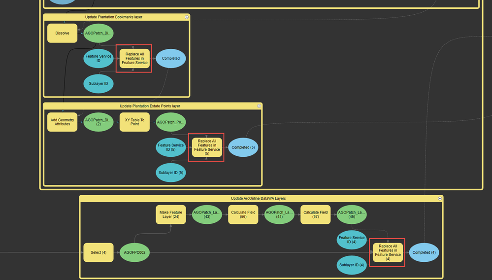

@RobertEisler I have modified the script as per below to include input and output parameters (Lines 10-12 & 144) which have replaced the variables that you edit at the beginning of the script.
(NOTE: I have also implemented the use of keyring to parse the login details for ArcGIS Online which means I don't need to store our password in the script: Lines 28-30)

By doing this, I can then save the script as a Python Script Tool in a Toolbox which you can load into a Model and parse data in as required (feature class, feature service ID, sub layer ID) and get a "Complete" variable output (Line 144) so you know when it's done (can use as a precondition for further steps). This means you can also use the same script over and over as per my demo below.
