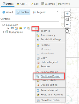

This document will walk you through how to hide a field in a pop-up using Arcade.  You can use this to hide a field that contains a particular value, or if the field is blank/NULL.

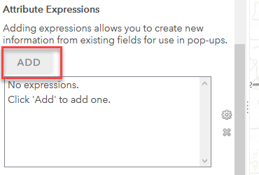

1.  Create an Attribute Expression for the field you wish to hide by clicking the 3-dot button next to the layer within the Web Map > Configure Pop-up
2.  Scroll down to Attribute Expressions and click Add:

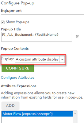

4.  Under Pop-up Contents change the Display to A custom attribute display
5.  Click CONFIGURE

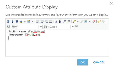

6.  In the Custom Attribute Display dialog, add any fields you wish to show in the pop-up

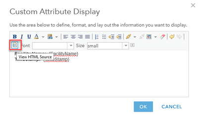

7.  To hide a field, you will need to switch to View HTML Source.  This will allow you to enter HTML code.
8.  Specify the following HTML to hide the field:
<span style="display:{expression/expr0}">
<b>Meter Flow:</b>  {Meter_Meter_Flow}<br />
</span>

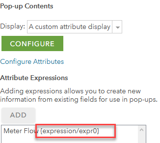

The expression/expr0 above is the id of the Attribute Expression previously configured:
{Meter_Meter_Flow} on the second line represents the name of the field.  This value will display if the IIF statement returns False.  Here is how the Custom Attribute Display appears:

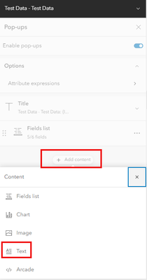

Is there a way to configure this type of schema in the new Map Viewer? I don't see an option for custom HTML pop-ups in there but the arcade abilities seem more robust. Is this functionality now baked in?
JakeSkinner
Esri Esteemed Contributor

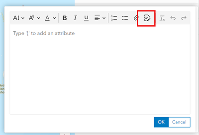

@NatalieRobbins in the new Map Viewer, select Add Content in the Pop-up pane, and then select Text:
You can then format your text with supported HTML using the Source icon:
