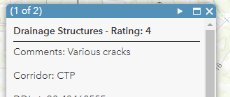

rbasgall
I was looking all over for a solution that I could only display non null field values with the field alias and ended up combining a few different things I found.
var features = FeatureSetByName($map, 'CTP_Roadway_Observations', ['*'], false);
var aDict = Schema(features);
var aArray = aDict["fields"];
var output;
for (var i in $feature){
    if (!IsEmpty($feature[i])) {
        for(var j in aArray) {
            var dict = aArray[j];
            if (dict['name'] == i){
                output += dict['alias'] + ": " + $feature[i] + TextFormatting.NewLine + TextFormatting.NewLine;
return output;
Produces this:
