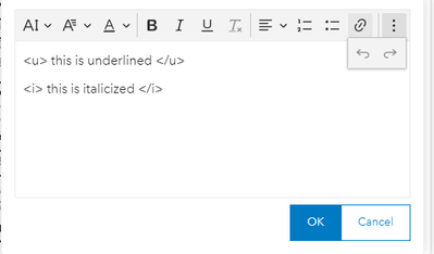

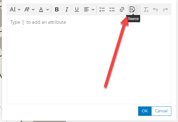

I am trying to modify the HTML of a text element that I've added to a pop up in Map Viewer (not map viewer classic). In ArcGIS Online, there is a "Source" button. In Enterprise Portal, this source button appears to be missing. I'm adding some screenshots:
1. ArcGIS Online:
Portal (and the HTML never renders):

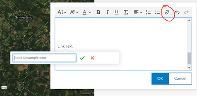

If you type out the text you want to embed the link to, then highlight it (or highlight the attribute field) and click on the hyperlink icon (circled below) you can paste the URL in the pop-up:
acharko
Thank you! That worked. I just added my expression into the URL and in the pop up, gave it a generic name.

If I remember correctly, I've done it by opening a map in Map Viewer Classic, adding the feature(s), then editing the html there, via the source button. Switch back to the regular view, copy it, then open the newer map viewer and paste it there  Alternatively, you can edit the pop-up in AGOL Assistant.
VanessaSimps
I was just playing with this again- looks like if you use the Visualization tab in the feature layer's detail page, you can get to the source button in the icon and save it out as a new layer, rather than doing the work in the Map Viewer.
