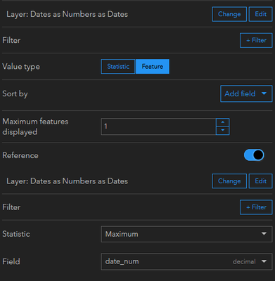

Indicator Settings
I've got my indicator looking at the data expression, and it's set to Feature. I also have a reference value set, and that's looking at the Maximum date number of the same expression. I'm also limiting it to a single feature.

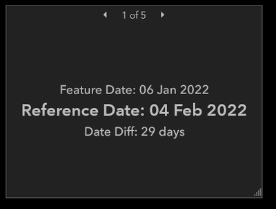

Now we've got two numbers that we've forced into the indicator's requirements, and a bit of Arcade can bring them back as dates.
var feat_date = Date($datapoint["date_num"])
var ref_date = Date($reference["max_date_num"])
var duration = Abs(DateDiff(feat_date, ref_date, 'days'))
return {
    topText: `Feature Date: ${Text(feat_date, 'DD MMM YYYY')}`,
    middleText: `Reference Date: ${Text(ref_date, 'DD MMM YYYY')}`,
    bottomText: `Date Diff: ${Round(duration)} days`

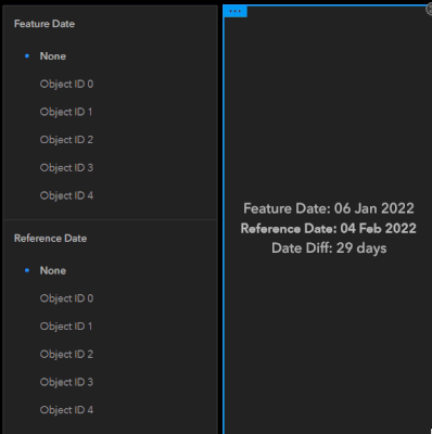

Selectors and Filtering
I've got two selectors set up. One targets the indicator value, one targets the reference. Both are based on the features in the expression.
If you wanted this to look nicer, you could amend the data expression to include additional fields for labeling, etc. 
And that should do it!
