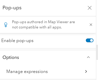

Hi there,

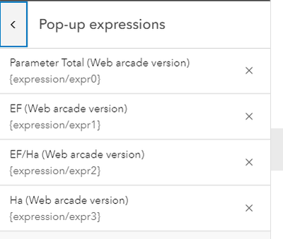

I've made two expressions EF and Ha using Arcade that I'd like to use in a Map Viewer pop-up. I've created them in the Managed Expressions area.
If I want to use both of them to create an additional expression, how do I do this?
I'm still new to Arcade and don't have a background as a coder.
Hopefully this is an easy question for someone!
I tried $feature.EF/$feature.Ha. That doesn't work though because $feature are fields written into the table and Arcade is front end only?
