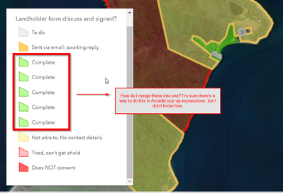

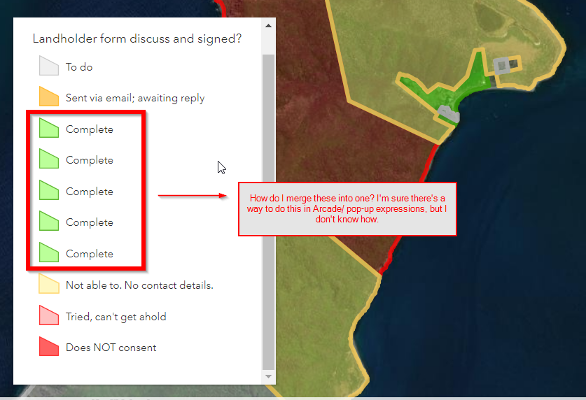

I'm getting into Arcade this week and have a few questions. I'm reading up on Arcade articles and learning a lot, but I'm still not sure how to apply this to my situation. These questions should be easy wins for those already versed in Arcade.
1. How do I merge the below symbology for Complete into 1?
$feature.ConsentFormStatus
CodeDesired text output
Desired fill colour @ 50% transparency
Desired outline colour. no transparency. width- 1
To doTo don/aGrey
Not able to. No contact details.Not able to. No contact details.OrangeOrange
In progress
In progressYellowYellow
Complete - DocusignCompleteGreenGreen
Complete - Pen and paperCompleteGreenGreen
Complete - S123CompleteGreenGreen
TriedTried. Can't get ahold.OrangeOrange
DoesNOTConsentDoes NOT ConsentRedRed

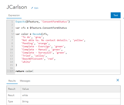

Expects($feature, 'ConsentFormStatus')
var cfs = $feature.ConsentFormStatus
var color = Decode(cfs,
    'To do', 'gray',
    'Not able to. No contact details.', 'yellow',
    'Pending', 'orange',
    'Complete - Eversign', 'green',
    'Complete - Manual', 'green',
    'Complete - Survey123', 'green',
    'Tried', 'yellow',
    'DoesNOTConsent', 'red',
    'white'
return color
- Josh Carlson

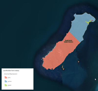

Hi @jcarlson , Thank you for your help. I'm not sure if I've followed your steps correctly, so I'm going to include some screen shots.

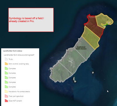

Current state:

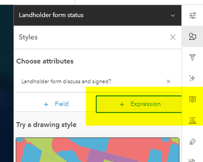

In Map Viewer, if I go to Styles, +Expression and add in the code you've shared, I get this.
I can work with this because it does do the grouping I need it to, but because I am also on my arcade learning journey, I'd like to get down to the bottom of this. Sorry if this is painful for you! We've got the code to group them, but not output the colour. I've been doing some reading up about how to do this, but I think I'm getting confused about how to apply it in pop-ups for Map Viewer and how it works differently in Dashboards and Experience builder...
