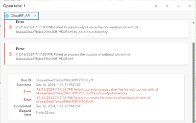

I am new to ArcGIS python coding and Notebooks, and am trying to develop a custom web tool for our experience builder app. I've successfully created a Notebook (using Notebooks through our ArcGIS Online portal) with input and output parameters, but I'm having trouble with correctly passing my output back to the client/app. The notebook simply takes a single point as input and uses the coordinates to call an external API. The API returns public URLs for a number of different data formats (options are KMZ, GeoTIFF, and SHP), and I'm a bit lost on the best way to use one of these URLs to display the results in the client's map (e.g. in experience builder or even just a web map). I keep running into a "Failed to presist output value files for webtool job with id b4eaaa0aa27b4ce29bb30ff19f305bc9 to job output directory" error. More details below.

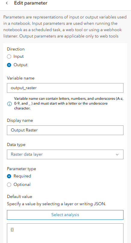

My output parameter:

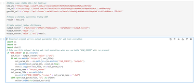

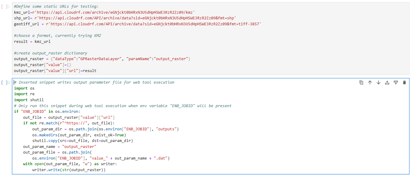

Here's an example of what I'm trying:

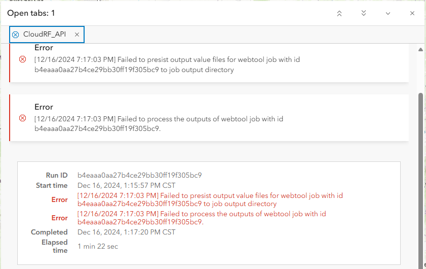

All cells seem to execute successfully, but I get this error in the result:

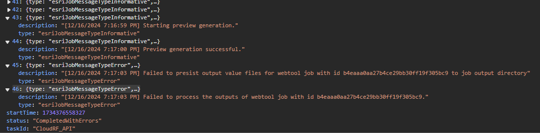

Developer tool view:
