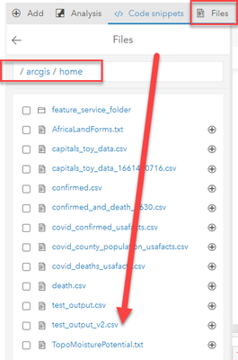

5. Last, convert it to a CSV file, keeping the columns you want.  Because you are using an AGOL notebook, you have to save it to the user workspace.  You can then navigate to the files tab and download the CSV locally.
# convert to csv file
df.to_csv("/arcgis/home/test_output_v2.csv", columns=['item_name', 'item_id', 'item_type', 'author'])

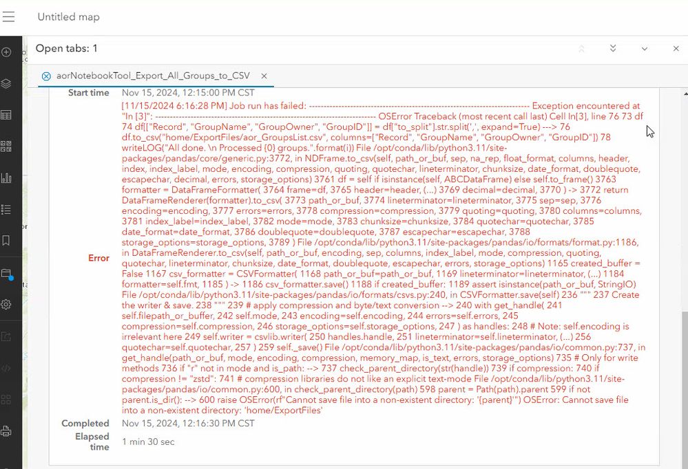

Alex_Rodriguez
Hello Nicholas,
I've done precisely what you suggested here.  I am able to create the CSV file...but when running the tool inside a map viewer I am getting an error that suggests the file/folder does not exist or I don't have permissions to the folder.
Any suggestions?
