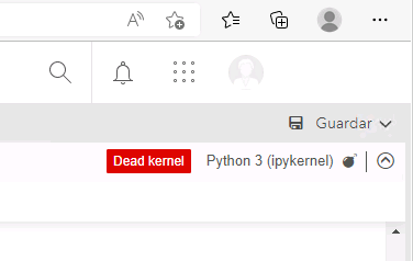

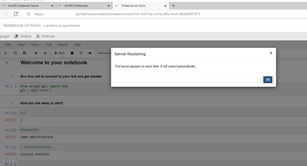

Issue: Using the ArcGIS elements in Notebook Server causes the kernel crash.
Error: The kernel appears to have died. It will restart automatically.

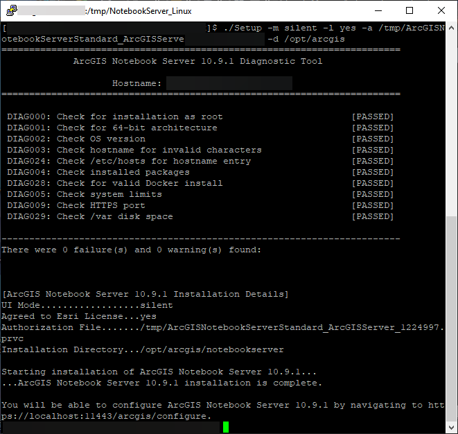

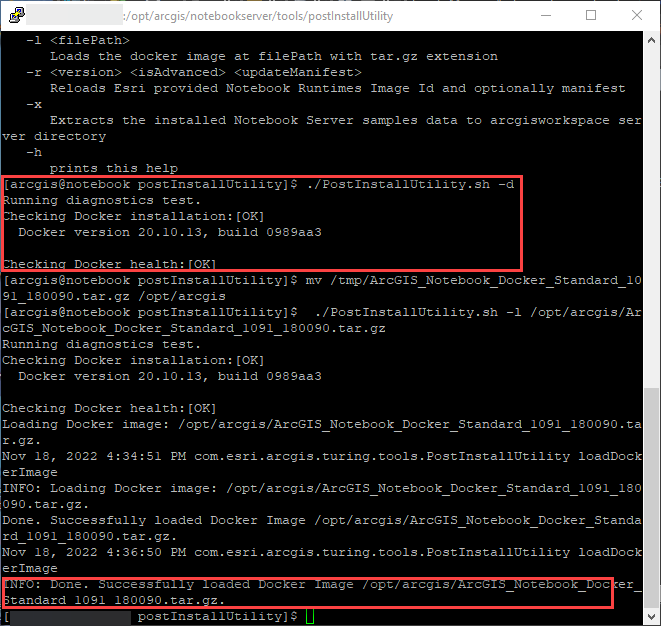

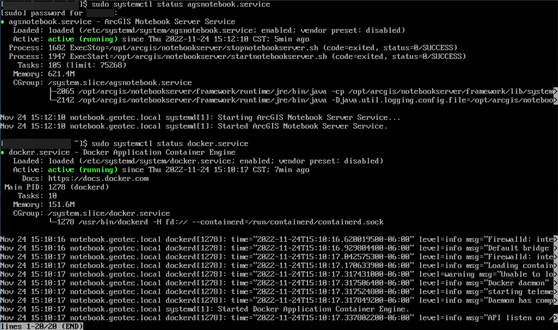

Docker looks fine, and the install process was done without issues.

○ Uninstall docker, and reinstall.
○ Uninstall ArcGIS Notebook Server and reinstall.

  4. Could you share the ArcGIS Notebook Server logs, after setting the log level to “Debug” and reproducing the scenario?
