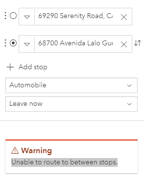

I am getting a strange error when attempting to simply use the 'Directions' tool, where inside Pro using the Routing Service that was published by aforementioned Network Dataset will properly produce a Route, where in a blank test webmap, the routing service may or may not produce a result. Sometimes it will produce a route, and other times it only states Warning, Unable to route to between stops.

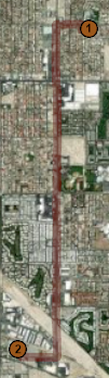

IE: ArcPro Imported stops from Address

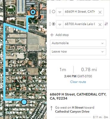

ArcPro Routing ServiceEnterprise Map Routing ServiceEnterprise Map Route Service other
Stop 1: 69290 xxxxxxx  Stop 1: 69290 xxxxxxx  Stop 1: 68609 xxxxxx
Stop 2: 68700 xxxxxxxStop 2: 68700 xxxxxxxStop 2: 68700 xxxxxxx

Attached is a quick 10sec video showing in a WebApp the above error (minus the ArcPro side)
