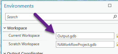

On the Analysis tab, click the Environments button.
In the Environments dialog, set the Current Workspace environment to the geodatabase of your choice.
When you run Copy Network Analysis Layer, the analysis data of the original layer will be copied into this geodatabase, and a copy of the layer will be added to the map.
