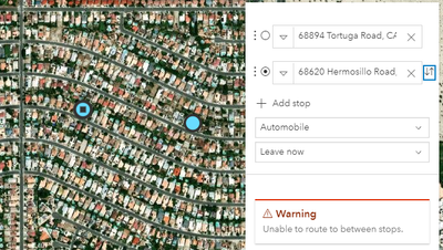

Hello,
I have created a test Network Dataset using in-house Street data maintained by our GIS dept, and used the Publish Routing Utility tool to publish and author it onto our server.

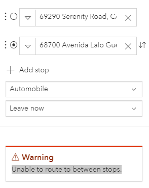

I am getting a strange error when attempting to simply use the 'Directions' tool, where inside Pro using the Routing Service that was published by aforementioned Network Dataset will properly produce a Route, where in a blank test webmap, the routing service may or may not produce a result. Sometimes it will produce a route, and other times it only states Warning, Unable to route to between stops.

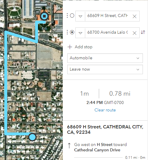

IE: ArcPro Imported stops from Address
ArcPro Routing ServiceEnterprise Map Routing ServiceEnterprise Map Route Service other
Stop 1: 69290 xxxxxxx  Stop 1: 69290 xxxxxxx  Stop 1: 68609 xxxxxx
Stop 2: 68700 xxxxxxxStop 2: 68700 xxxxxxxStop 2: 68700 xxxxxxx
Amarz_0-1654724324167.pngAmarz_0-1654724324167.pngAmarz_1-1654724518510.pngAmarz_1-1654724518510.png
I have a geocoder that works, everything works in ArcPro connected to the same services the MapViewer Map is using, any help is appreciated.
Attached is a quick 10sec video showing in a WebApp the above error (minus the ArcPro side)

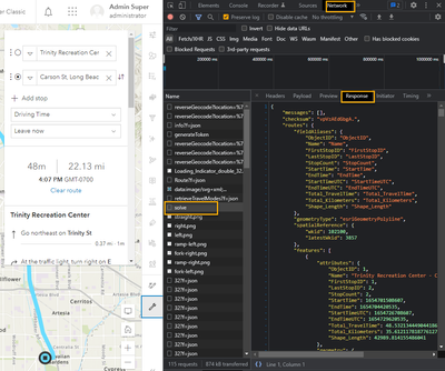

ArcGIS Pro uses the Route (Asynchronous) service while Directions widget uses the Route service (Synchronous). Could you turn on browser developer tools (you should be able to hit F12 in Chrome or Firefox), and then switch to Network tab. Find the request end with NAServer/Route/solve, and switch to response tab, which should give us more information on why it failed.
amarcz_cc
Thank you Max,
I was just watching your Video! Great work.
So I am getting the error in the attachment basically saying:
{"messages":[{"type":50,"description":"Input field [Match_addr] was not mapped to a field in the network analysis class \"Stops\"."}
I know for a fact those addresses are in my Servers Geolocator though..
Strangely, if I reverse the search order, it will work on certain queries.
Amarz_0-1654729155537.pngAmarz_0-1654729155537.png vs
MaxZeng
Thank you! Glad you liked the video.
Yeah, this is a warning message from the solve request, which just means some fields from your inputs cannot be mapped to our internal analysis class, nothing to worry about here. I don't expect this to cause the "Unable to route to between stops" message you see on the directions widget. Looking at your full error text file, I think the one you sent over is a successful solve with some warning messages, a failed solve will have a json like this:
{ "error": { "code": <code>, "extendedCode": <extendedCode>, "message": "<message>", "details": [ "<details>" ] } }
I would suggest to clear the network traffic (see the screenshot below), and then get directions again, and find the solve request (if there are multiple find the one that failed), and see whether you get an error response in the solve request. Thanks!

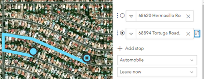

And when swapping the Address 1 and Address 2 it runs successfully..
