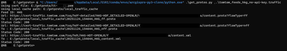

Not sure what the parse error is.  Lets ensure you can download the files outside of pro.  I have attached a zip that with use a Python and a "traffic" file to download the data. Update the .traffic file with your apikeys and the path to your pem file.  Then run the python script ... Usage: python get_protos.py <traffic_file>
When I run this I get the files below
Trouble-shooting  this in the past sometimes the issue is the pem file, its incorrect or out of date.
Troubleshooting  this in the past sometimes the issue is the pem file, its incorrect or out of date.
Here's the output from running the getproto.py (+ .traffic):
getproto.py outputgetproto.py output

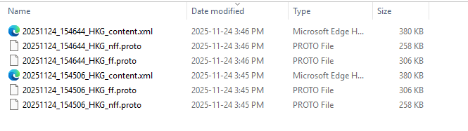

I also get the same files as you:
getproto output filesgetproto output files
