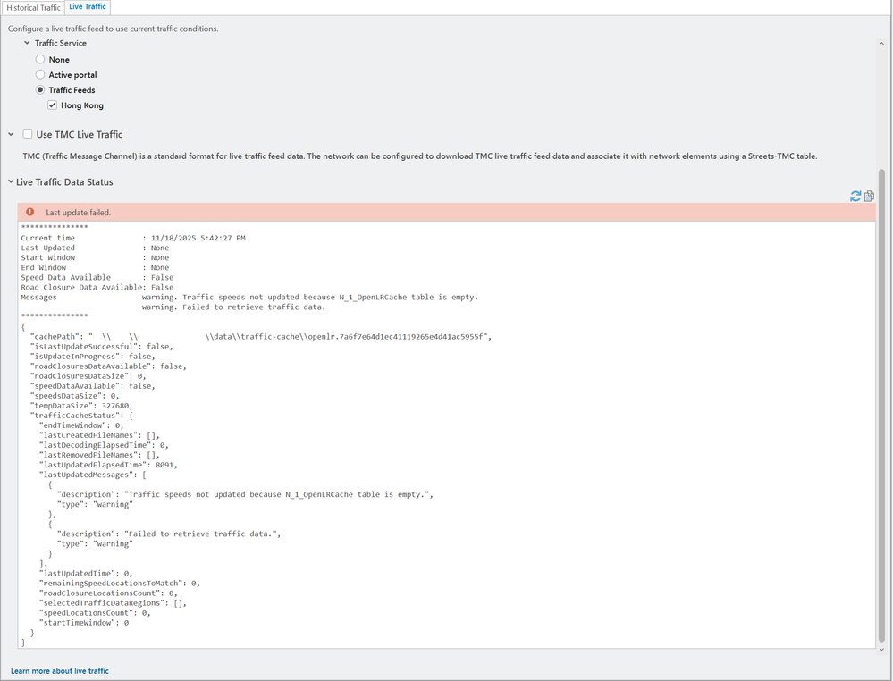

  • I opened the "Traffic" tab in the Network Dataset Properties for my network dataset
  • The Live Traffic Data Status shows:
    "Last update failed" and the following messages:
Current time : 11/18/2025 5:46:52 PM
Last Updated : None
Start Window : None
End Window : None
Speed Data Available : False
Road Closure Data Available: False
Messages warning. Traffic speeds not updated because N_1_OpenLRCache table is empty.
warning. Failed to retrieve traffic data.
"lastUpdatedMessages": [
"description": "Traffic speeds not updated because N_1_OpenLRCache table is empty.",
"type": "warning"
"description": "Failed to retrieve traffic data.",
"type": "warning"
Question 1:  Is this a bug??? What does this error mean?  How can I fix it?

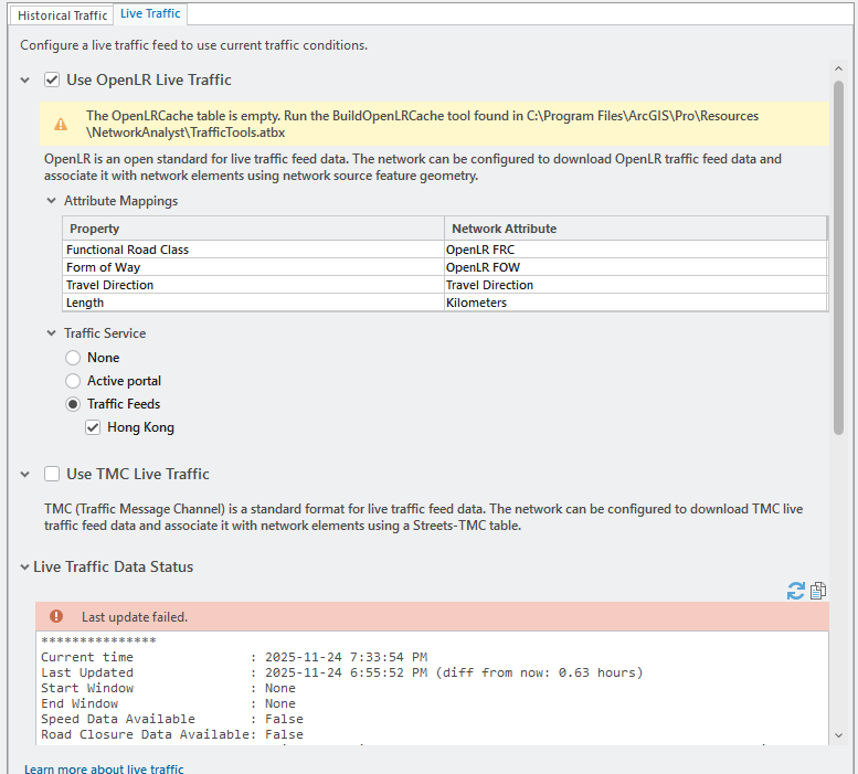

Question 2: The document says "The appropriate network attributes for Functional Road Class, Form of Way, Travel Direction, and Length" How do I configure the Network Attribute Mappings? What is the correct workflow for this?
> This need to be mapped to network descriptor attributes, I believe you must of mapping something (cutoff in the UI screenshot above) otherwise I don't think the UI would allow you to apply the OpenLR traffic config
Yes, you're correct - those must be mapped in order to apply the OpenLR traffic config.
Since there wasn't any published guidance on how to create these attribute mappings,
I just made a guess and manually created entries in the "Travel Attributes" --> "Descriptors".
Strange how I created the descriptor (which supposedly is an attribute mapping, but where do I tell it the field name to map the named descriptor to?)
As in, when i create a new descriptor in the network dataset properties, it just has a "Name", "Units", "Data Type", "Parameters" and "Evaluators" ... but how do i tell it to map to the "FRC" field?

- so the attribute mapping as shown in the screenshot in the help is from the SMP data we create (from a different version of TomTom data )
- As in the dialog shown of the OpenLR attribute mapping in the help they point to descriptor attributes "OpenLR FRC", "OpenLR FOW", and "Travel Direction" (and distance).
The data you have needs to have attribute that adhere to the OpenLR spec, in the help under "Configure OpenLR live traffic from a traffic service" it has a table that has a link to the OpenLR spec pdf.
Although Mulitnet classic has FOW and FRC I don't believe they are the same as what is defined in the OpenLR spec.  And I'm not sure about Travel Direction in Mulitnet classic yet.
As an example, the esri SMP date we create has specific attributes for these and their definitions are below.  But the source data is from not Multinet classic, and I believe during processing of the raw data these might be created (that is the source data we use might need to be manipulated to adhere to what OpenLR needs)

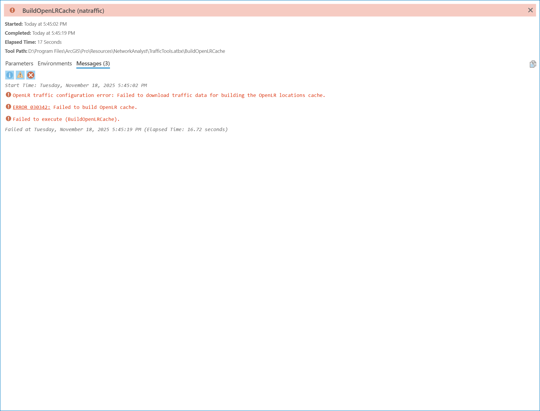

Looking a the above some more when you ran the `BuildOpenLrCache` you got the error
I don't think the Mulitnet values out the box could be used but even so I don't believe you should get that error.  The tool should run but probably not find many or any matching OpenLR string to features.
Can you provide the .traffic file you use? But REMOVE your apikeys from the urls, similar to the way the help shows it, e.g. <APIKEY> vs actual key, like below

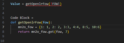

I looked at the multinet data regarding the fields need to create the network descriptor attributes.
1) for the Functional Road Class you need a new feature class attribute, something like OpenLR_FOW,
And then I believe its values can be mapped as below from the MultiNet FOW:
- FOW=1 --> OpenLR_FOW=1
- FOW=2 --> OpenLR_FOW=2
- FOW=3 --> OpenLR_FOW=3
- FOW=4 --> OpenLR_FOW=4
- FOW=8 --> OpenLR_FOW=5
- FOW=10 --> OpenLR_FOW=6
- all other FOW values --> OpenLR_FOW=7
2) The FRC values seem ok as is, so it could be used directly.
3) The FT and TF_Travel_Direction looks like it is same as TF_AllVehicles_Restricted and FT_AllVehicles_Restricted, so those could be used directly.
So the above fields can be used to create the 3 descriptors in the screenshot in previous reply.
Okay, implemented and will put it in the field script evaluator:
getOpenlrFow()getOpenlrFow()

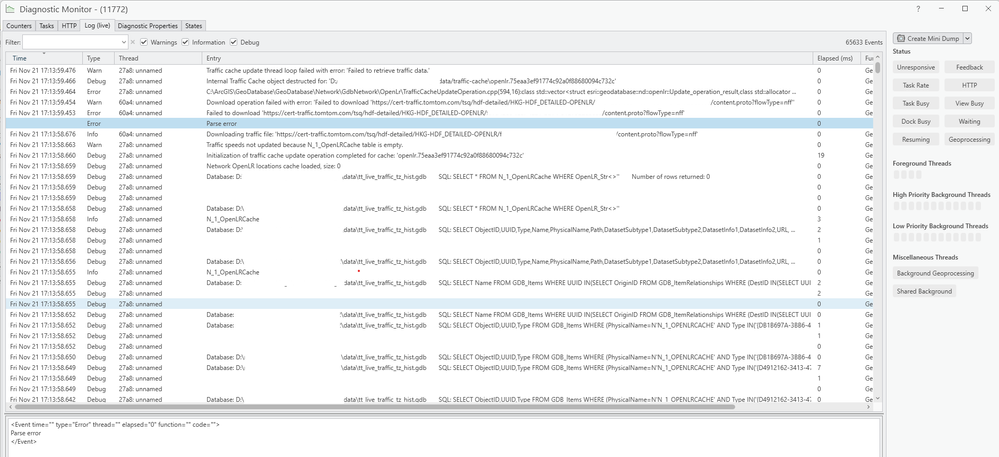

Hi @FrankK
More debugging fun ... :
Event time="Fri Nov 21 15:18:28.895" type="Error"
     HTTP Status 406 returned when downloading
     https://cert-traffic.tomtom.com/tsq/hdf-detailed/HKG-HDF_DETAILED-OPENLR/---APIKEY---/content.proto?...
Details: Accept-Encoding header must be present and support gzip.�x8np$�@~ۮ�
Then I noticed your sample .traffic file has some interesting additions:
"acceptGZipEncoding": true,
"tdsCompressionLevel": 5,
These are not documented in https://pro.arcgis.com/en/pro-app/3.5/help/analysis/networks/live-traffic.htm
How can we ensure these get properly added to the documentation?

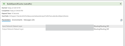

Anyway, continuing ... So I plugged them in and ...
But it returns this:
Processed
Matched: 0
Unmatched: 3431
Already cached: 0
Outside extent: 0
Removed: 0
Total: 3431
And in the Network Dataset properties - after running "BuildOpenlrCache" gp tool:
success, maybe?success, maybe?
So - in summary:

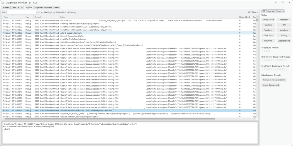

  • Through a lot of instrumentation in Pro, found out all paths leading to getting the traffic data from TomTom resulted in a HTTP 406 error
  • Specifically, the server side is looking for a "Accept-Encoding" key with the corresponding value "gzip"
  • Added the (undocumented) "acceptGZipEncoding" and "tdsCompressionLevel" to my .traffic and BuildOpenlrCache now shows success

It seems to be getting data ... but it says "Unmatched: 3431" where as I get  "Matched: 3402 Unmatched: 28" and the dialog still says "OpenLRCache table is empty."
Can you create and share a map package of a very small area (but where there would most likely be live traffic) like
Top 22.3410495190063
Left 114.147091423107
Right 114.147091423107

I removed the "acceptGZipEncoding" and "tdsCompressionLevel" from my .traffic file and it still works.  That being said we are probably hitting different servers so maybe possible they are configured differently and the one you hit does require it.  But I have added an issue to include those in the doc.

@FrankK :
.traffic configuration file:
dot-traffic config filedot-traffic config file
