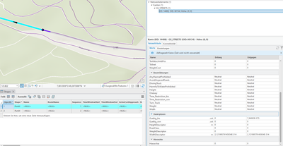

 we have figured out so far:
We are able to reproduce the issue with a local ArcGIS Pro 2.9 and 3.1
The initial buld locally returns some really strange Descriptors:

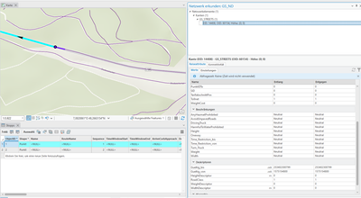

And after the local rebuild using the same template the descriptors look perfect.
also the costs (distance in m) is correct after rebuilding.
