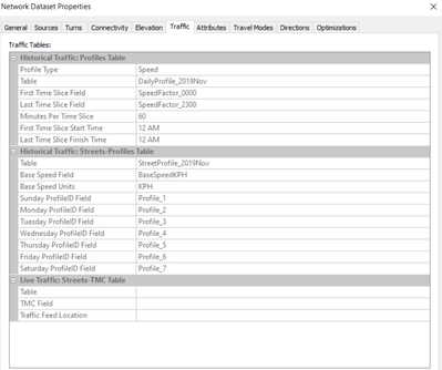

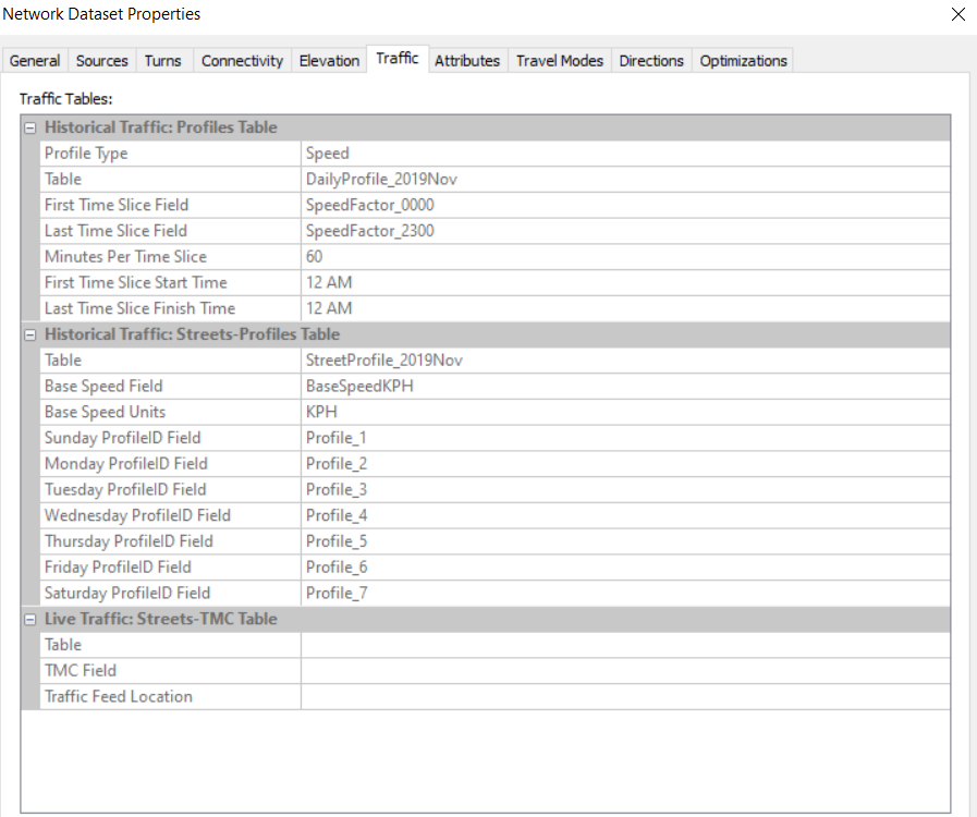

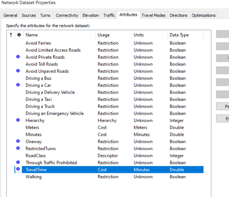

I have successfully created and built my network dataset with Historical HERE traffic data. However, Network Analyst tools are not using my traffic data to calculate travel time. No matter what time of the day I chose to run the tools, it only came back with the "free-flow" (or the Fallback attribute) travel time.
Here are some screenshots of my ND settings:
Any ideas or help would be appreciated.

In your Network Analyst tools, can you verify that you are using the TravelTime cost attribute?  Also, in the Network Dataset Properties, can you verify that the TravelTime attribute is using the Edge Traffic evaluator?
In the DailyProfiles_2019Nov table, can you verify that the SpeedFactor_0000 through SpeedFactor_2300 fields all have values between 0.0 and 1.0 (see https://desktop.arcgis.com/en/arcmap/latest/extensions/network-analyst/traffic-historical-10-1-and-l...)?
