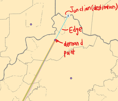

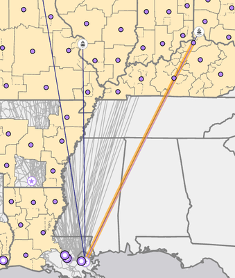

Here is my example.  I found the route from a facility to a demand point is like this.
The route follows the straight line that I created from origin-destination points.  However, the exit should be at the junction.  When the line met the demand point, it just exited there.
