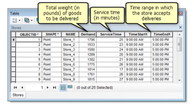

The input time that I want to add is similar with the following table.
Therefore, I would like to know is how can I add time as shown in figure. I want to add 9:00:00 AM and 5:00:00 PM for TimeStart1 and TimeEnd1.

If you are using shapefiles...
Geoprocessing considerations for shapefile output—ArcGIS Pro | Documentation
Date fields only support date and do not support time.
Caution:
The nonsupport of time in date fields is a serious limitation for any tool that performs temporal analysis.
