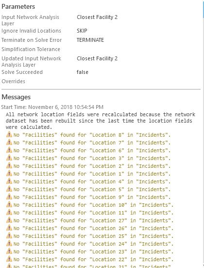

I am getting a solution error while running the closest facility analysis in ArcGIS Pro
1. I created a network dataset using a road network (in arccatalog), two different points feature layers. I did that in a geodatabase after having all feature classes in a multi-feature dataset. All the feature layers in the gdb have the same geographic coordinate system.
2. Then in ArcGIS Pro, I start a closest facility layer and add the same two point  feature layers to incidents and facilities. There are 522 incidents and 28 facilities. I "snap" them so they are connected with the network.
3. Then I run the analysis and I get no solution - i.e. the analysis is not able to find any facility for any incident. (attaching a picture).
Can anyone tell me what could the problem be?

Most likely there is some issue with the network dataset. Have you done a simple route on that network to make sure you are able to find correct paths?
Also, what does the "two different feature layers" in your description mean?
Is it possible that you have included the incident and facility point feature classes as sources in the network dataset? If yes, then if they are not directly on line features, they will become stand alone junctions and your incident and facilities in the closest facility layer will snap to these stand alone junctions and not find any paths in the network. In this case, remove these two point sources from the network dataset and rebuild the network and then create a CF layer and solve.

thanks!! removing them from sources helped..

Second, I think we need to know more about your analysis settings and the network dataset itself. The error "No 'Facilities' found for 'Location X' on 'Incidents'" could indicate several things.
