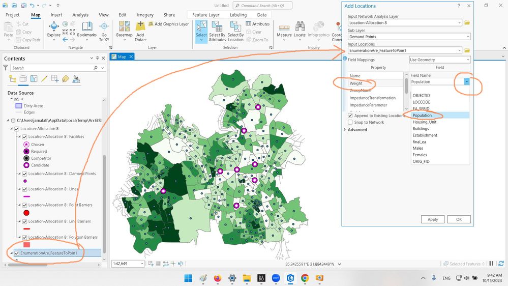

You should map the population to the Weight field.
The Location-Allocation tutorial has an example of this: https://pro.arcgis.com/en/pro-app/latest/help/analysis/networks/location-allocation-tutorial.htm

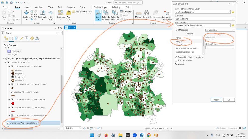

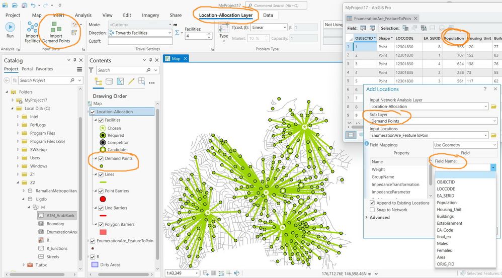

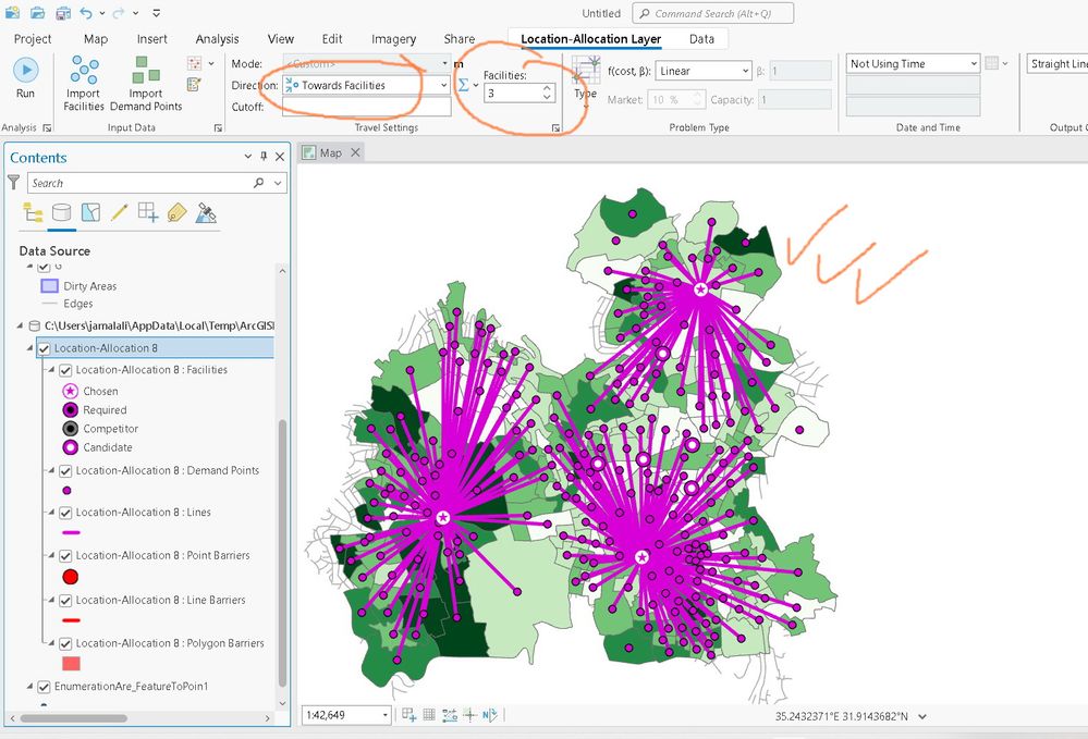

I have tried it with and without setting the “population” a s a weight, the result is as shown in the screenshots below
