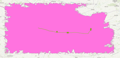

Green is not a line but the correct service area polygon.
Pink is the result when I use arcpy.nax for the same analysis. It seems to ignore my prohibitions (bus is only supposed to use bus line)
