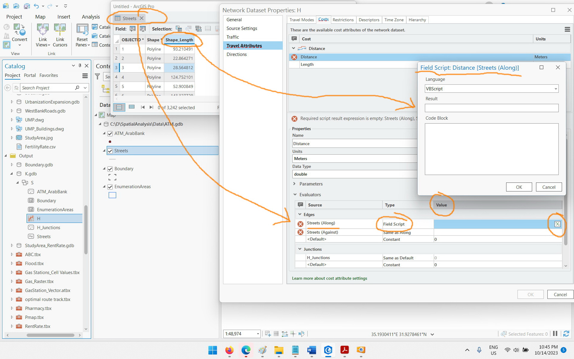

As per the screenshot below, the attribute fields of the “Streets” layer are not populated when choosing the value of a “field script”.
Why do we need to write the name of the field manually?

Hi Jamal,
You are correct; in the Field Script (or Element Script) evaluator dialogs, there is currently no list of fields (for Field Script evaluators) or network attributes (for Element Script evaluators). We have plans to improve the experience of creating Field Script and Element Script evaluators and to make it more similar to other expression editors, such as Calculate Field. I don't have an estimated time of arrival on when it will happen, but it is a high priority project for us.
