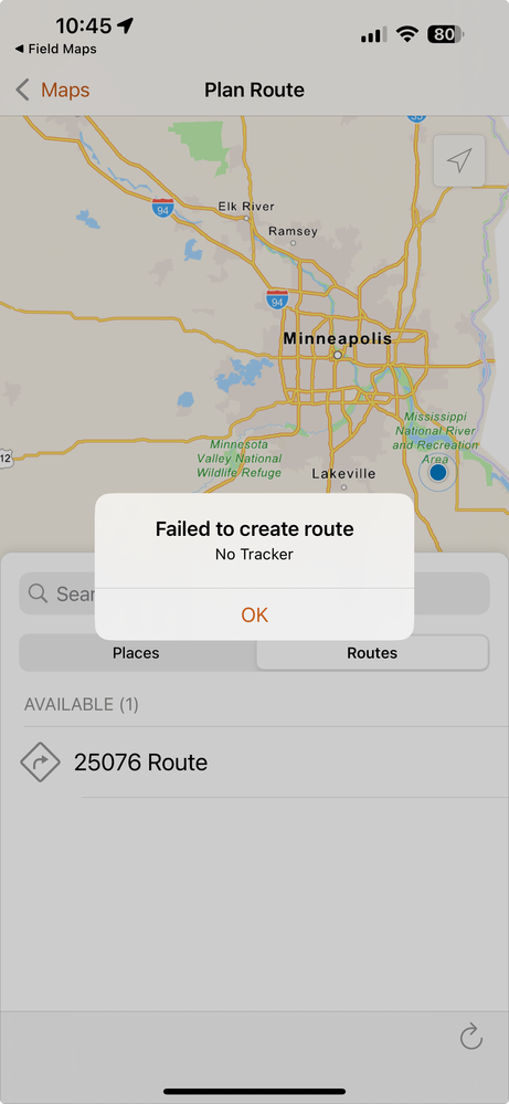

Keep getting this error, unsure why. The route is shared with my organization, and it is still not working.

Would you be able to share any screenshots of the network, along with the errors you're getting? I'd also be sure to check that the network is creating junctions at vertex crossings and not just endpoints.

I created the route on ArcGIS online,arcgis issues.pngarcgis issues r.png not on the pro. Simple route.

Been doing some additional searching for this, just a long shot, is location sharing turned on for your org?

That was not turned on. I did this and it did nothing. Any other ideas?

@ErikPliego What tool did you use to create the route? Also, for the map you are using in ArcGIS Navigator, is that an Esri provided map or did you create that map with your own data?
