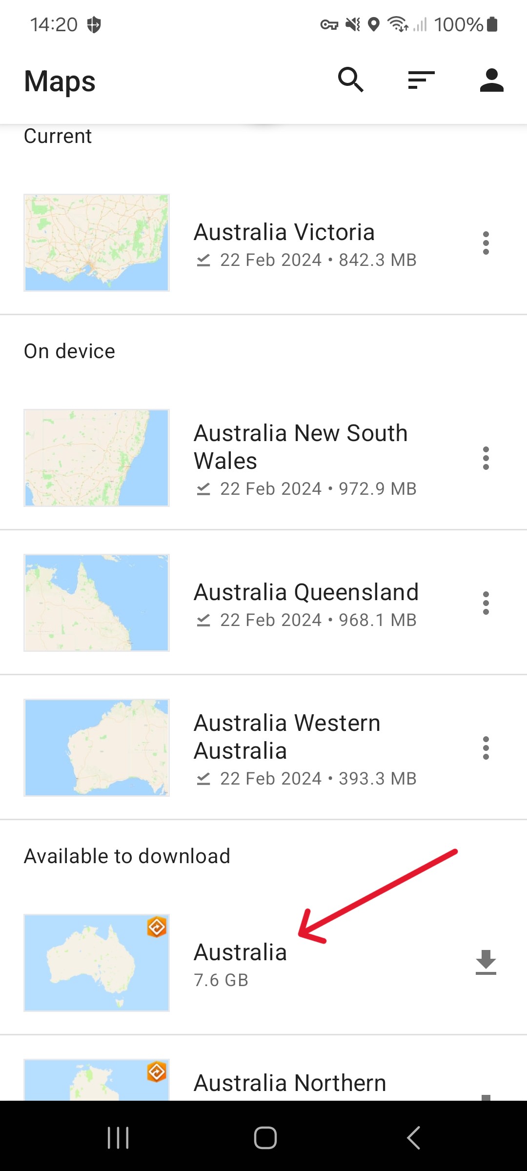

I am having problems with ArcGIS Navigator when downloading AGOL mobile map packages (mmpk's) that are over ~3.4GB.
For example when I try and download the Australia mmpk (7.6GB) using the android navigator app it starts to download, but reports that it is only 3.3GB in size, when it reaches 3.3GB downloaded it just fails with no errors.
When I try and download a smaller mmpk such as Western Australia (393.3MB) it successfully downloads.

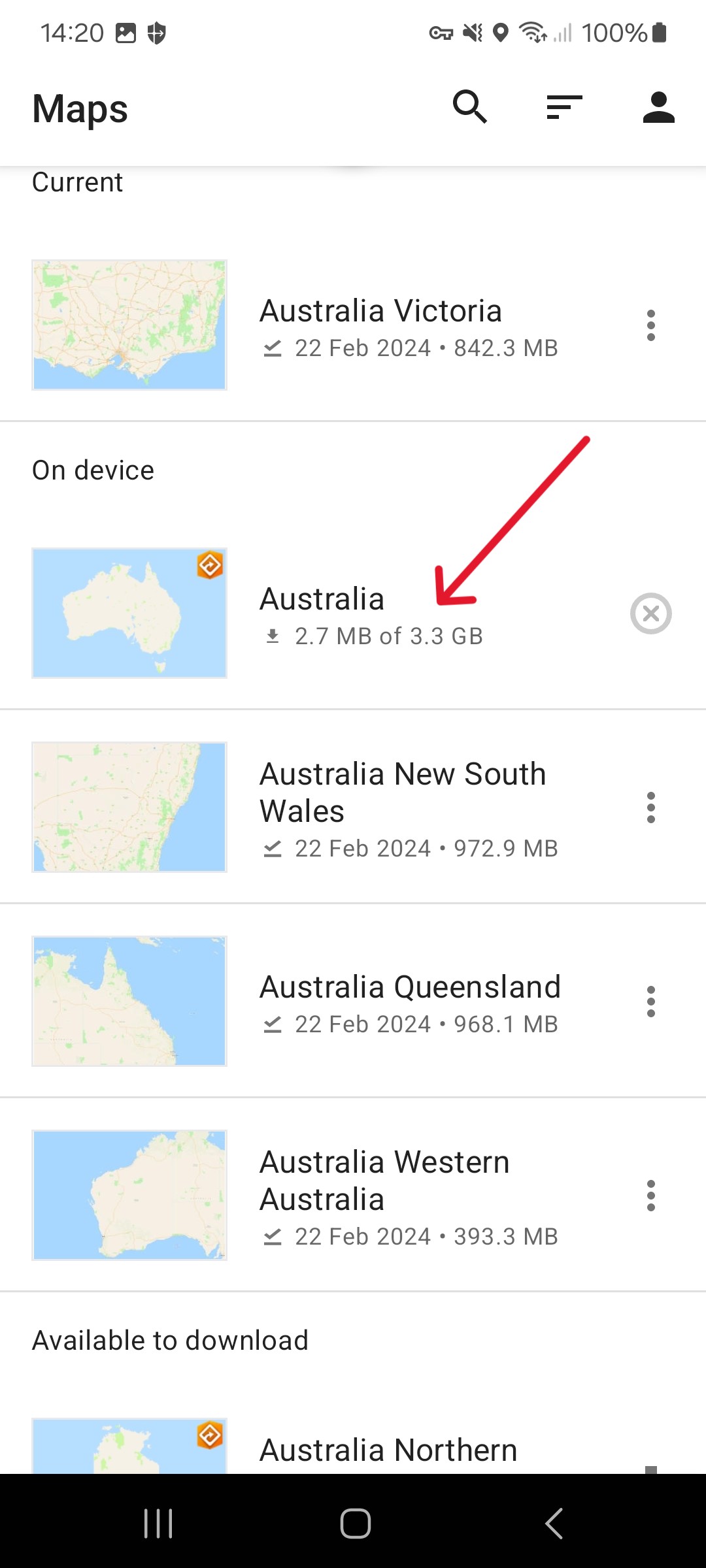

Hi Kerri, further to my previous post I have now tried it on a Samsung Galaxy Tab S7 FE 5G and it has the same issue.
For some reason the app thinks the file size is different once a download has been started:
Australia - 7.9GB in Gallery but when downloading it reports 3.3GB
UK - 3.9GB in Gallery but 3.4GB when downloading.
Both files complete the 3.3/3.4GB downloads but then pop back in the gallery rather than the downloaded files.
