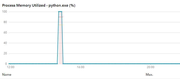

When I added a Windows host component to be monitored, i observed a metric named : "Process Memory Utilized  - Python.exe%" . I saw a suddent spike on this metric to 100%. But when I looked into the Host server at the time of alert, I could not see any huge memory consumption by python.exe.
How is this metric calculated? there is some description about this in the Monitor Help pages. But can someone let me know how this metric is calculated? monitor metric.JPGmonitor metric.JPG

For process information, we use Win32_PerfRawData_PerfProc_Process class.  To calculate above %, we use WorkingSetPrivate/Total Physical Memory *100.  We have noticed that sometimes this process class returns short spikes both for CPU and memory that don't correlate perfectly with the total CPU and memory utilization.

Thanks for the Explanation Andew. Will use this details to configure the alerts in a more relevant way. I hope this issue gets fixed in the future versions , so tha we can reliably use the metrics to alert / process further actions.
