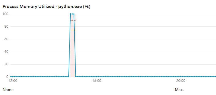

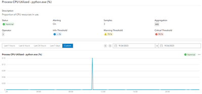

When I added a Windows host component to be monitored, i observed a metric named : "Process Memory Utilized  - Python.exe%" . I saw a suddent spike on this metric to 100%. But when I looked into the Host server at the time of alert, I could not see any huge memory consumption by python.exe.
How is this metric calculated? there is some description about this in the Monitor Help pages. But can someone let me know how this metric is calculated? monitor metric.JPG
AndrewSakowicz
For process information, we use Win32_PerfRawData_PerfProc_Process class.  To calculate above %, we use WorkingSetPrivate/Total Physical Memory *100.  We have noticed that sometimes this process class returns short spikes both for CPU and memory that don't correlate perfectly with the total CPU and memory utilization.

Thank you @RadhakrishnanNeelakantan  for the feedback.  To help us understand this case better, can you share some additional info:
  1. memory total
  1. memory utilized, instances and CPU charts for the above corresponding time and python.exe?
3. elaborate on "at the time of alert, I could not see any huge memory consumption by python.exe.".  What was the python.exe utilization in task manager?  Please confirm this was during the time reported python.exe was 100%.

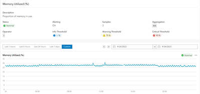

Hi Andrew,
Here are the details for the same time period:

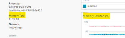

1.Memory Total:
Memory Utilized (total)
Process CPU Utilized for python:

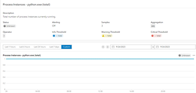

Process Instances Python:
Memory used python
AndrewSakowicz
Thank you for this additional information.  Please let us know if this happens again.  One way to stop alerting is to increase number of samples to 5.  Note, ArcGIS Monitor is using and reporting the values from this class.
