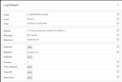

Hi there,
I'm seeing a few of these popping up
in the resource column is that the observers table id #8 - so this:
this will help me track down what's failing.
Thanks
Fraser

I've see cases when log files are large (debug or not rotating) and querying times out.  Any chance this is your case?
fraserheagle
Deactivated User
Hi Andrew - the logs are ~2GB for the server logs and ~7.3GB for the services logs (there are a lot of logs) - is this large enough to cause timeouts?
