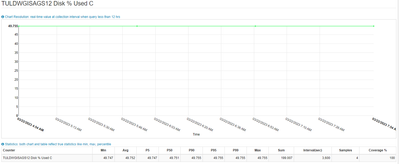

We currently track % of disk usage with alerts Example:
Is there a way to track % of disk usage with alerts in Monitor 2023?  I can see the amount of GBs used on a disk but, unable to see % and setup an alert.

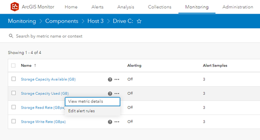

Please try this workflow:
1. Login into ArcGIS Monitor > Monitoring tab
2. Under the Filter folders - select Storage
3. Select the storage device you want to set an alert on - this will display the overview metrics page for the storage device
4. Select the Metrics tab (in the upper right banner) - this will display the different properties of the storage device
5. Click the ellipsis button (the three dots) for the parameter you want to set the alert on, for example "Storage Capacity Used (GB)" > Edit alert rules
6. The Edit Alert Rules dialog should appear for the selected parameter and you should be able to set an alert

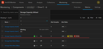

EsriEvan
Hi @SteveMcCarthy - totally understand your point. We will address this immediately. It will go into 2023.1
