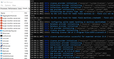

@LachlanWainwright Through Esri Support we found out that you can run Monitor Server in debug using the following commands in a Powershell
PS C:\Users\Administrator> cd \
PS C:\> cd esri
PS C:\esri> cd .\ArcGIS\Monitor\Server\bin\
PS C:\esri\ArcGIS\Monitor\Server\bin> $env:LOG_LEVEL='debug'
PS C:\esri\ArcGIS\Monitor\Server\bin> .\arcgis-monitor-server.exe --serve
In my case, I immediately saw the reason why the service won't start:
*** UnKnown can't find 10.0.0.185: Non-existent domain
Error: Command failed: for /f "tokens=2 delims=:" %a in ('nslookup 10.0.0.185 ^| findstr /B Name:') do @echo %a
at execSync pkg/prelude/bootstrap.js:2115
⁃ Module._compile
pkg/prelude/bootstrap.js:1930
PS C:\esri\ArcGIS\Monitor\Server\bin> nslookup 10.0.0.185
Server: UnKnown
Address: 10.0.0.180
So, as you can see, if the machine is not joined properly to a domain / or can't resolve its IP address, it will not start.
Now, I reconfigured my virtual server and properly configured reverse lookup in my local DNS, then, when running Monitor Server, it starts just fine, and stays running.
The nslookup results are now working:
Server: UnKnown
Address: 10.0.0.180
Address: 10.0.0.185
In a nutshell, one of the first things that the Monitor 2025 software does is to perform this nslookup with the server IP address. If that fails, then it will not run successfully. @DerekLaw not sure if this needs to be in the documentation under "System Requirements"
