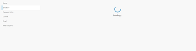

I can not try to reconfigure the database at all as the database section under the system is just loading
when checking the web browser request  url : https://FQDN/arcgis/admin/database/status - the response is 502 bad gateway
