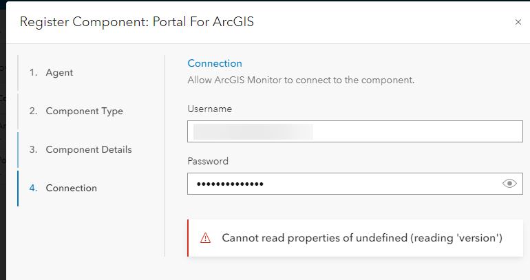

When trying to register the Portal machine, I get a "Cannot read properties of undefined (reading 'version')" error. Nothing yet on the Google machine and not sure where to go. Same account used for all other machine in the environment. Have done the WMI steps and added user to Performance Monitor users....
Anyone have thoughts? Thanks
CodyPatterson
MVP Regular Contributor
Not really sure why it didn't occur to me, but this is also the same error I got when my username and password was incorrect.
I had to use the portaladmin account that was created when it was first deployed.
Cody

Craig_Lunde
I got that error too and for me it was wrong username/password.
CodyPatterson
