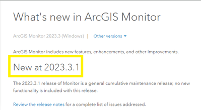

Hi @DerekLaw ,
I can see from the ArcGIS Monitor documentation that version 2023.3.1 has been released.
But I can't find the setup for the same from my Esri. Below is the screenshot attached for the same
Can you tell me when we can expect to get it available on my Esri?
Thanks
Ayush
DerekLaw
Esri Esteemed Contributor
Hi @AYUSHYADAV,
ArcGIS Monitor 2023.3.1 is scheduled to be released today. I will post an update when it's available on MyEsri. Thanks for your patience.
UPDATE: The release is now available
