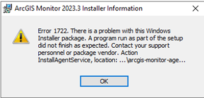

Hello, I am installing ArcGIS Monitor Agent on a Windows server 2019 machine and it comes back with this error. I am using domain account that has required access on the server.
Any ideas what is missing here?

Working with ESRI Support and they suggested to install using a domain user password with no special characters. We have strict password policy that needs to include special character as part of company standards. Is there a way to know what special character needs to be excluded or is it all special characters?
Another observation, I am able to install the application on other machines without any issues.
