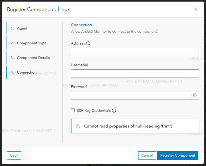

We are trying to register a Linux component with the host OS already upgraded to RHEL 8.6 version based on the recommendation.
After inserting the required fields and registering the component, we get the following error.
Cannot read properties of null (reading 'trim')
Kindly advise

Hi Josh
I am receiving this error when connecting to a linux CentOS variant container (turnkey linux) (may or may not be related).  Using username/password, not ssh. Works when connecting to ubuntu VMs.
Can you shed any light on the situation from your investigation 04-10?
Using ArcGIS Monitor 2023.1.
Thanks
Tom

Hi @GeoJosh
We upgraded our ArcGIS Monitor to 2023.1 and initially when we tried to register our Linux host we got the following error
ssh -G <domain-name-of-our-Linux-host>
'ssh' is not recognized as an internal or external command,
operable program or batch file.
Then we moved on and added other components and then tried again after refreshing the page and all. Then we got the following error
